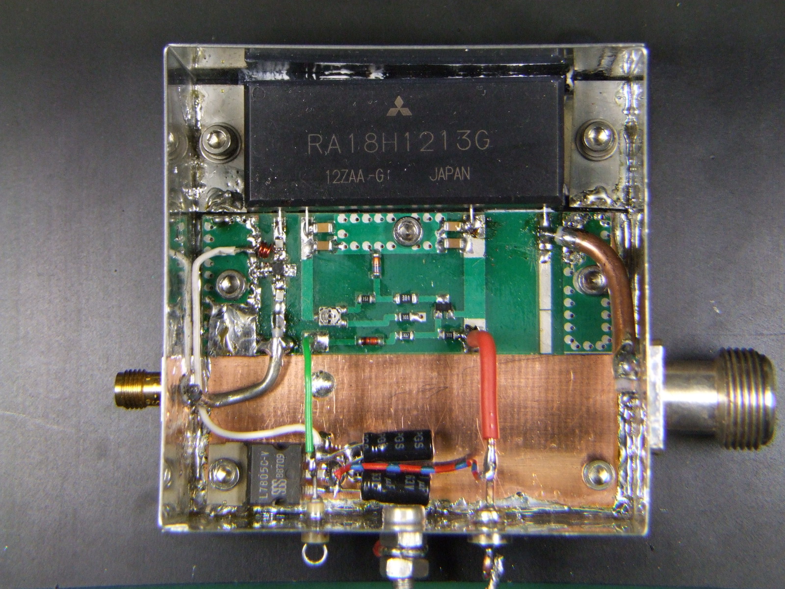

Hello,
see attached document.
You can build it for +/- €80 ... (excluding heatsink and fans).
This document is including frequency response, FM-ATV and DVB-T measurements.
73 - Patrick - ON1BTE
